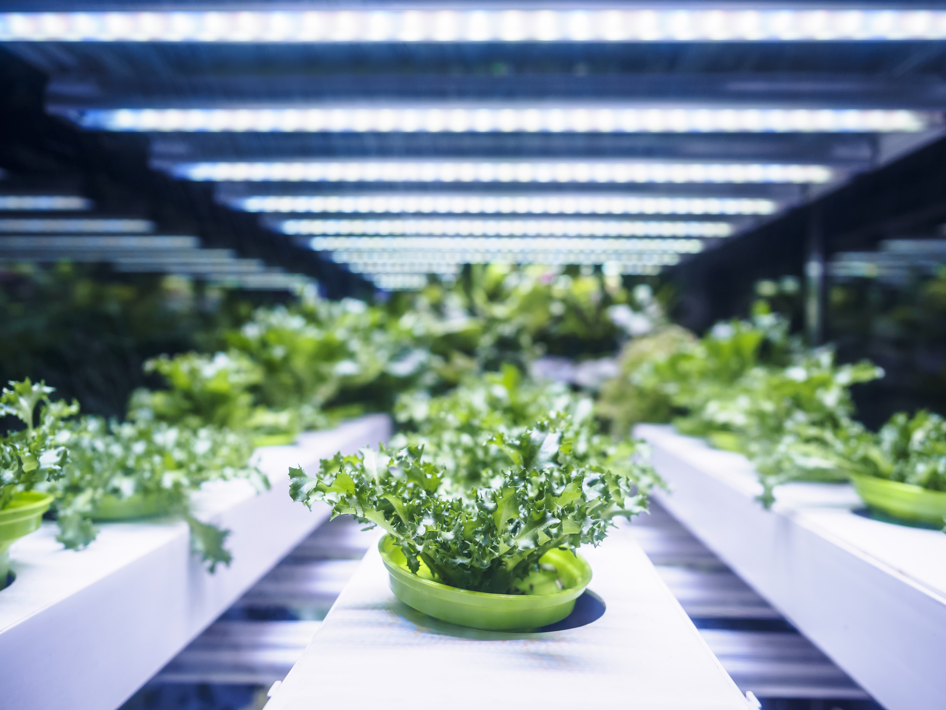

Question: Does horticultural lighting require GFCI protection?
See the answer below.
Answer: Yes
Explanation: A new Part XVI was added to Art. 410 in the 2020 NEC. Section 410.184 requires GFCI protection of horticultural lighting equipment employing flexible cords.
