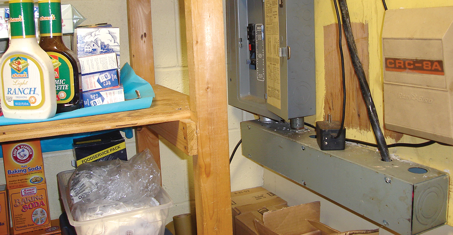

Little Shop of Electrical Horrors
There are a lot of problems to point out here. The most obvious one is the lack of working space in front of this panelboard. The shop owner installed those shelves in the exact spot where an electrician would need to stand to work safely on this energized panelboard. This is a violation of Sec. 110.26(A), which requires a minimum depth of 3 ft, a minimum width of 30 in., and a minimum height of 6½ ft be kept clear in front of the panelboard. Section 110.26(B) clearly states that this working space cannot be used for storage, yet unfortunately many electricians must deal with this violation on a regular basis. At least the door on the panelboard cover was left open; otherwise, the breakers would not have been accessible without removing the cover.
Another problem is the lack of connectors and supports for the NM cable entering the wireway. Section 300.11 requires cable assemblies to be securely fastened in place. Section 334.30 requires NM cable to be secured within 12 in. of the cable entry into the wireway. This cable is simply shoved into an opening with no connectors or staples to protect or secure it. The unused openings in the wireway must also be closed to comply with Sec. 110.12(A).
