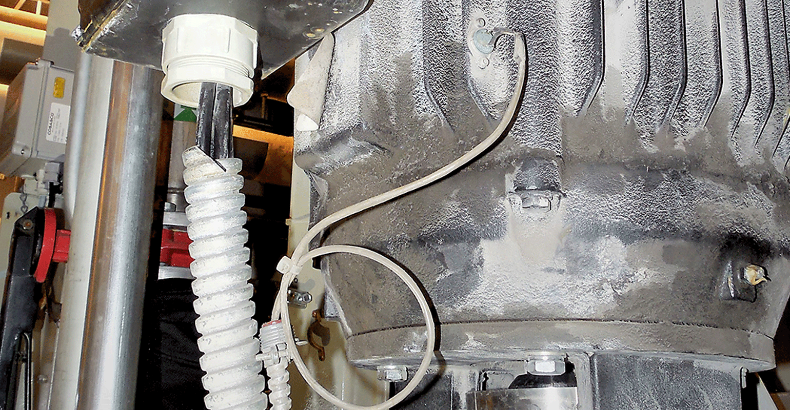

    Indecisive Installer
    It looks like this installer could not make up his mind on whether he should use metallic or non-metallic wiring methods for this motor. No worries, though, because he solved that problem by simply using both types. Of course, that solution caused some other problems — the most noticeable being the failed connection between the flexible metal conduit (FMC) and the non-metallic conduit connector. Fittings and connectors must be used only for wiring methods for which they are specifically designed and listed, as required by Sec. 300.15. My next concern is the lack of electrical continuity between the FMC and the metal motor. Section 300.10 requires metal raceways to be metallically joined and mechanically secured to metal enclosures, boxes, cabinets, and fittings in a manner that will provide effective electrical continuity. That certainly did not happen here. The lack of a fitting on the end of the FMC also has me concerned about any sharp metal edges eventually wearing through the insulation on the conductors because of all the vibration from this 40-hp, 480V motor. A short circuit or ground fault could create a catastrophe. A properly installed FMC connector would have been a good choice for this installer.
