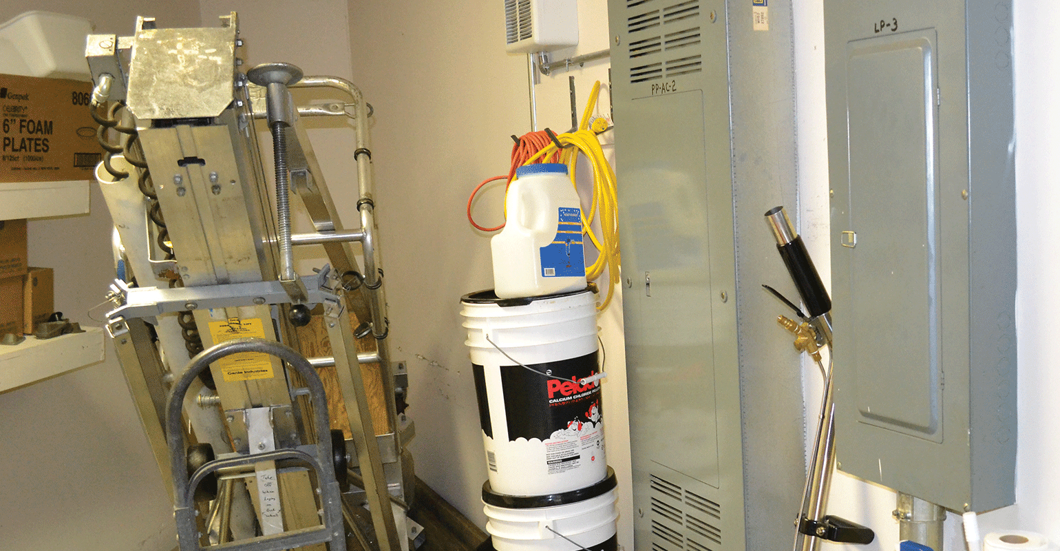

This collection of photos was sent to us by John A. Weber, principal electrical engineer for The Hartford Steam Boiler Inspection and Insurance Co. in Hartford, Conn. He spotted these NEC violations on a recent visit to a church building mechanical room that was originally built in 1973.
Photo 1 shows a classic example of what can happen in a room where panelboards, switchboards, and other electrical equipment are located. The working spaces for this equipment quite often get used for storage, even though Sec. 110.26(B) clearly states: “working spaces required by this section shall not be used for storage.” This Code rule can’t be any clearer than it is now.
The clear working space dimensions required by Sec. 110.26 extend from the front of the electrical equipment to a depth of 3 ft in front of the equipment. The width of the working space is required to be at least 30 in. wide or the width of the equipment if wider than that. The height of the working space extends from the floor to a height of at least 6½ ft or the height of the equipment if it is higher than that. This area must remain clear and free of obstacles that can increase the danger level for electrical workers when working on this energized electrical equipment.
