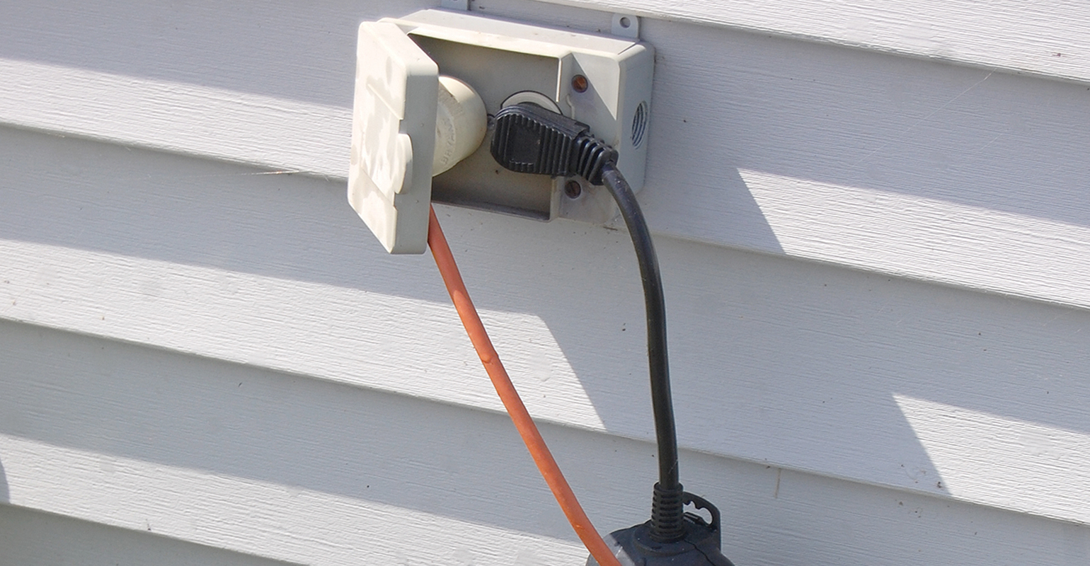

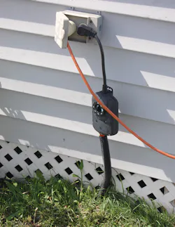

Crazy Cord Connections
This receptacle cover is not only mounted in the wrong position, it’s the completely wrong type of cover in the first place. This cover is designed to be installed so it can open vertically, not horizontally. Installing covers in the wrong position violates the requirements of Sec. 110.3(B) if the listing and instructions require a certain orientation such as “vertical only.” For wet locations, Sec. 406.9(B)(1) requires 15A and 20A, 125V and 250V receptacles to have an enclosure that is weatherproof even when an attachment lug cap is inserted. The cover in the photo would only be weatherproof when it was closed, and of course, if it was mounted in the correct position. Another concern I have is with the extension cord plugged into the timer. It was run underground beneath the grass approximately 100 ft to provide power to a boat dock on a lake. That does not seem safe at all. The cord is not designed to be buried in the ground. Using cord sets in this manner to provide power to the dock area could create a dangerous shock hazard in and around the water if this cord gets damaged. It also violates the requirements of Sec. 400.12(7).
