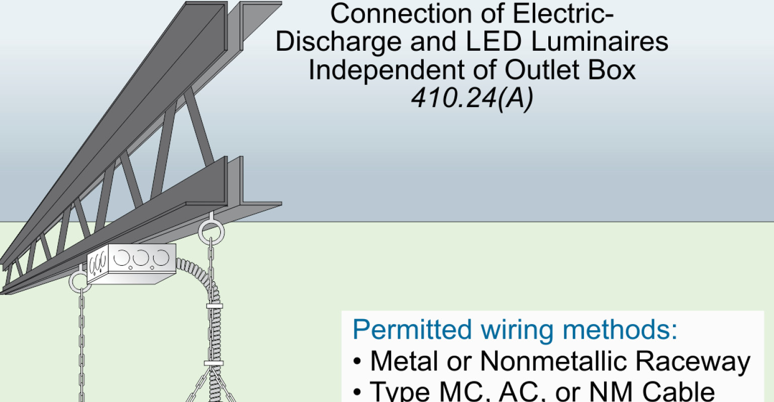

Q. What does the Code allow for the connection of electric-discharge and LED luminaires when they are supported independently of the outlet box?
A. Electric-discharge and LED luminaires supported independently of the outlet box must be connected to the branch circuit with a raceway, or with Types MC, AC, NM cable, or flexible cord installed per Sec. 410.62(B) or (C) [410.24(A)] (see Figure).
Electric-discharge luminaires can be cord-connected if the luminaires are provided with internal adjustments to position the lamp [Sec. 410.62(B)].
Electric-discharge luminaires can be cord-connected if the flexible cord is visible for its entire length, is plugged into a receptacle, and the installation complies with Sec. 410.62(C).
