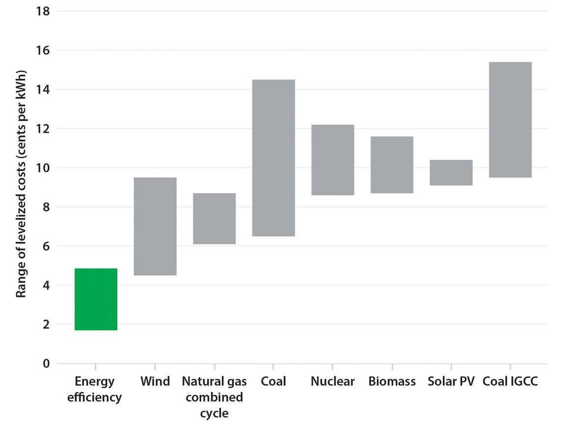

The report looks at the cost of running efficiency programs in 20 states from 2009 to 2012 and finds an average cost of 2.8 cents per kWh---about one-half to one-third the cost of alternative new electricity resource options, as illustrated by the following graph from the report:
Levelized costs of electricity resource options. Source: Energy efficiency data represent the results of this analysis for utility program costs (range of four-year averages for 2009-2012); supply costs are from Lazard 2013.
