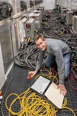

Photo 1. Integrated load bank testing of UPS performance and cooling.
