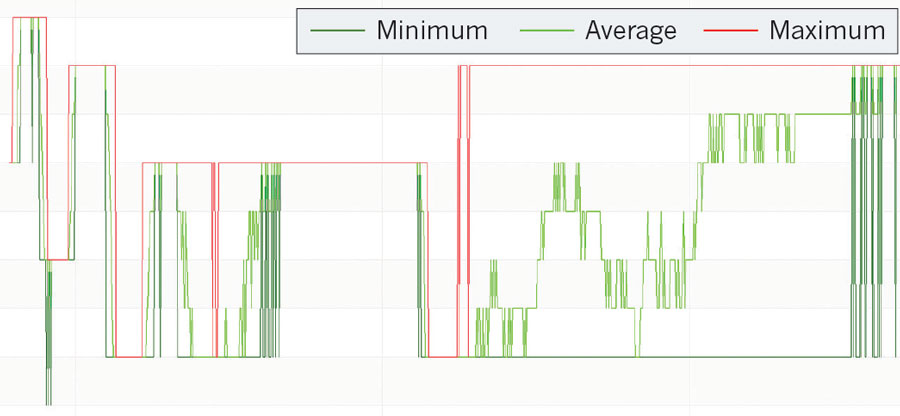

Fig. 1. Power factor measured on a 100W incandescent lamp.
Incandescent lamps provide an almost ideal resistive load at power line frequencies. A load that is totally resistive, with no reactance, results in a power factor of 1.0. This is an ideal condition, allowing all current supplied by the distribution system to be consumed as real power by the lamp. For the purpose of taking control data, a standard 100W incandescent lamp was used. Measurements were made using a receptacle-type power quality recorder. The two power quality measurements investigated were the total harmonic distortion (THD) and true power factor. The THD quantifies the amount of current harmonic distortion introduced into the distribution system, while the true power factor is a measure of the overall power delivery efficiency (including reactive and harmonic effects).

For reference, the incandescent lamp tested actually consumed 102W (Fig. 1). Graphs of power factor and harmonic magnitude with incandescent lamps are included as a control or reference to compare to low-energy lighting (Fig. 2). A resistive load will add very little harmonic distortion to the voltage waveform — any current distortion from the lamp is a reflection of the incoming voltage distortion.
