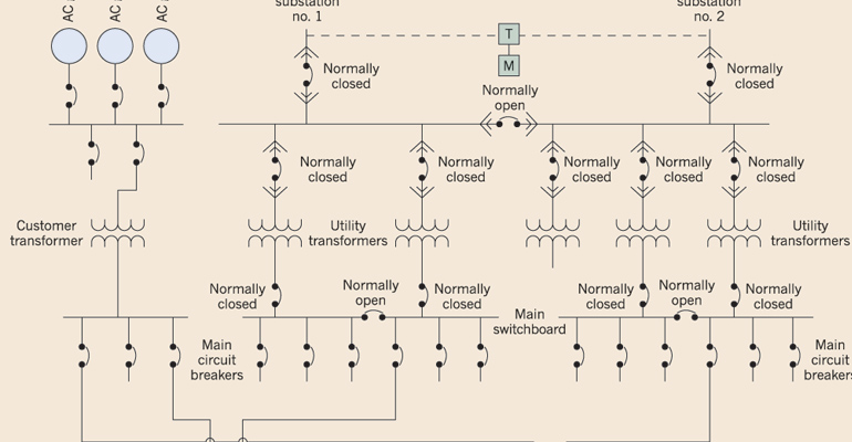

Figure 1 is an example of an EPS featuring dual electric utility feeders, two ATSs, a two-sided bus with a tie breaker, and three generators — all powering an emergency bus and two normal buses. Critical branch circuits and other loads on normal circuits can be powered from either electric utility feeder or the emergency generator bus.
C&I facilities use some type of lighting system powered from all three buses. Emergency lighting circuits may be derived from the critical branch circuit. Many facilities that use EPSs are planning or have already upgraded their lighting systems to include LEDs. It is a known fact that LED lighting is sensitive to power quality disturbances, especially disturbances that contain voltage transients.
Normal and EPS buses are subject to different types of power quality disturbances. Normal buses are subject to disturbances generated by everyday electric utility operations and internally generated disturbances caused by breaker switching and load switching. EPS buses are not subject to electric utility power quality problems, but they are subject to EPS power quality issues and disturbances generated by breaker operations and load switching occurring on EPS buses. EPS power quality includes the disturbances generated when any ATS operates.
