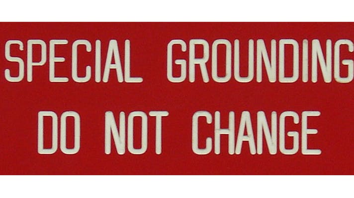

During a power quality inspection to evaluate the integrity of a critical communication uninterruptible power supply (UPS) system, a discovery was made in one of the 125A panelboards. After evaluating the UPS installation, we proceeded to inspect all the downstream panelboards. At one of the downstream panelboards, a red placard had been placed on the door (Photo 1). It read, “SPECIAL GROUNDING – DO NOT CHANGE.” We had never seen a sign like this, so it piqued our curiosity to say the least. It also made us proceed with great caution.
The National Electrical Code (NEC) doesn’t have a section for “Special Grounding,” nor would most electricians ever use this phrase. Before opening this panel to inspect it, we put on our 40 cal/cm2 arc flash suits. One person carefully removed the cover while another trained his eyes on what lay behind the cover as it was slowly removed. Once the cover had been removed, we were stunned with what we found. Can you identify the safety issue in the Photo 2? What were the installers trying to accomplish?
