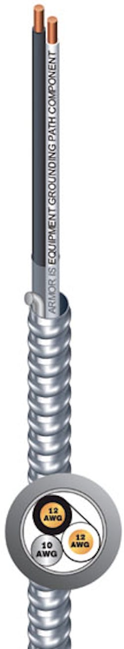

UL listed and NEC compliant, MCAP cables use the interlocked armor as an equipment grounding conductor — unlike traditional MC cable, which features a grounding conductor underneath the Mylar tape. In its patented design, the armor in MCAP is equivalent to the green copper ground in conventional MC cables. This is accomplished through interlocked armor and an aluminum grounding/bonding conductor, which are in direct contact throughout the entire cable length. To install, users cut off the aluminum ground flush with the armor, and then attach fittings, listed for use with the cable, to bond the cable to the electrical box.

“On HCF MCAP and MCAP you get some significant labor savings from the standpoint of simplifying the cable termination process and eliminating the makeup of the grounds in the box, wire nuts, pigtails, and the ground screws,” says Temblador, noting that there's also less volume in the box by taking the grounding conductor makeup out of the equation.
Although this product reduces the number of connections required for grounding, Temblador emphasizes they're not giving up anything in the process. “Because the NEC requirement mandates that installers bond the green copper grounding conductor to the metal box or enclosure, in order to create an effective ground fault path, if something's going to short, it's likely to short the metal,” he says.
