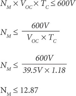

Example 1: Given the NEC information in Table 1 and the PV module data in Table 2, calculate the maximum quantity of modules you can connect in series. Assume the system voltage is 600V, and the location is Detroit, Mich.
The first step is to go to Solar ABCs and find the lowest ambient temperature in order to determine the proper correction factor. The extreme minimum is -19°C. Based on NEC Table 690.7, the correction factor would be 1.18. The maximum number of modules (NM) connected in series is given below.
The maximum quantity of modules connected in series without exceeding the 600V based on the location is 12 modules. If string sizing doesn’t seem like fun to you, then there are online string sizing programs to help.
