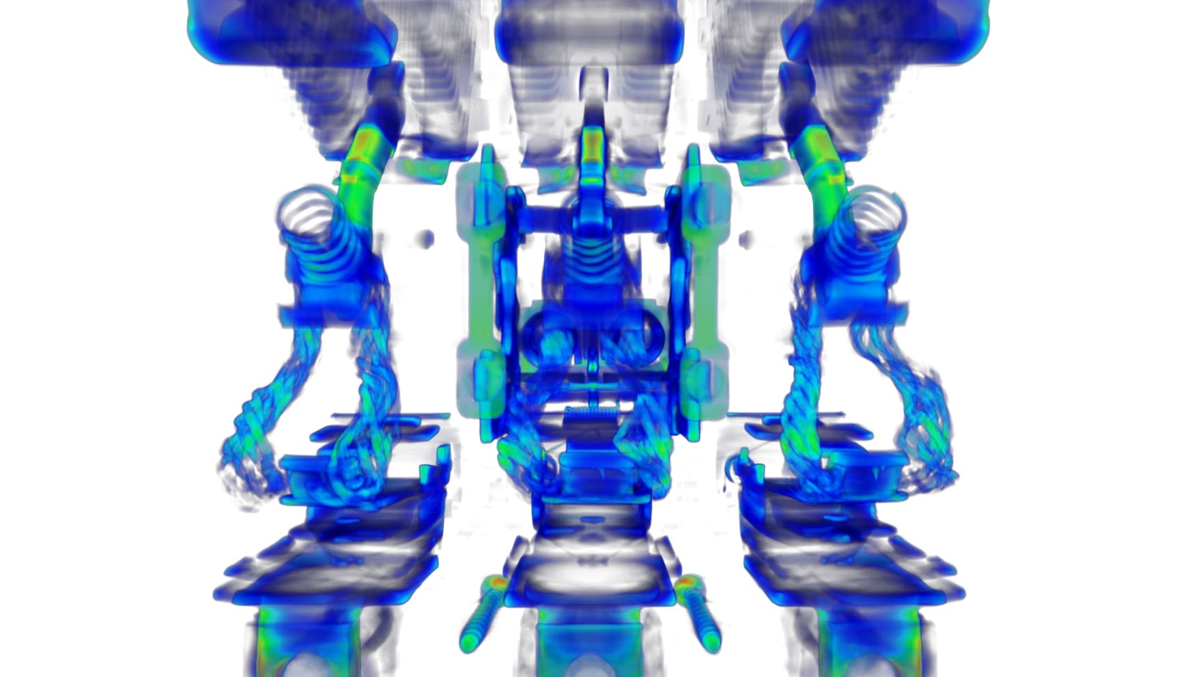

    What happened to the AC breakers in our PV fields? Although the makes, models, and descriptions of the MCCBs in this study have been removed and scrubbed from the data shared here, these breakers are from well-known, prevalent manufacturers. Breakers recovered from the sites exhibiting PQ issues were tested for resistance and impedance. Failed units were visually imaged using X-ray and physically disassembled and inspected for damage. All breakers examined displayed a higher impedance when compared with a factory-fresh device. Each pole was measured to determine whether a pattern could be seen in the limited sample set.
    All breakers showed higher per-pole impedance compared to a new, stock device. The impedance across the damaged breaker poles with the breakers closed showed a 10 to 100 time increase in resistance compared to known good breaker poles. Figure 6 shows five damaged breakers (A1, B1-3, and C1) and one known good example (N11). Measurements were taken using a stock inductance, capacitive, and resistance (LCR) meter, set up for 60-Hz frequency response. Resistance values were validated using a standard milli-ohmmeter.
    The new/good breaker showed less than 1 milliohm of impedance per pole, whereas faulty poles measured between 0.01 and 1 ohm (100–1000 milliohms), as shown in Fig. 6. Additionally, the resistances were not all the same within the same breaker, with B1, B5, and C1 showing per-pole resistances varying by as much as 10x between poles.
    By modeling the impedance in terms of voltage drop, using measured values in Fig. 6, we can calculate voltage drops of 10VAC with an assumed load of 150A, as shown in Fig. 7. Voltage drops of 10VAC or more across the breaker contacts will result in an increase in THD. If the distortion levels increase beyond a few percent, sensors in the inverter will flag a PQ fault and will shut down the unit to protect the electronics from damage.
    These results explain why some of the breakers were not obviously damaged or “crunchy” in operation, but still created issues. When the voltage drop is small per phase, the standard infrared (IR) thermographic imaging does not show an overheated breaker. However, the voltage drop across the breaker is no longer balanced between phases, creating a small phase imbalance at each breaker. Three-phase systems need to be as symmetric and balanced as possible to provide clean power, and voltage or current imbalance in the breaker phases can propagate into higher distortion levels.
