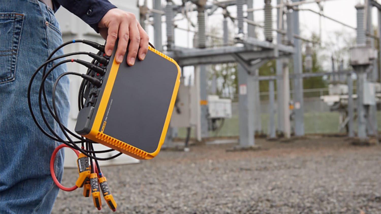

To conduct an effective power quality analysis, you’ll require specialized equipment, including:
  • Power quality analyzers: These devices are designed to measure key parameters such as voltage, current, harmonics, and power factor. They allow you to pinpoint inefficiencies and irregularities in your energy system.
  • Oscilloscopes: These are useful for visually inspecting voltage and current waveforms, which can help you quickly identify issues like transient events and waveform distortions.
  • Data logging devices: These tools enable you to track energy consumption and power quality trends over time, providing valuable insights for long-term planning.
Selecting tools that are user-friendly, reliable, and compliant with industry standards can simplify the testing process and ensure accurate results.
