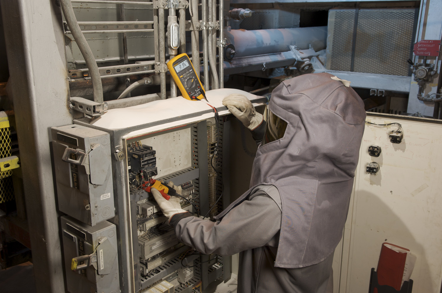

Digital multimeters have come a long way in increasing safety by offering a higher level of protection against transient voltage spikes. The CAT rating combined with the
voltage rating on the multimeter indicates the level of transient protection.  The higher the CAT rating, the higher the transient protection.

Heavy-duty digital multimeters increase transient resistance
The International Electrotechnical Commission (IEC) defines the safety standards for test equipment. Digital multimeters (DMMs) have come a long way in increasing safety by offering a higher level of protection against transient voltage spikes. One way to determine the level of transient protection is to look at the CAT rating. That rating — from CAT I to CAT IV — combined with the voltage rating of the multimeter indicates the level of transient protection.
The CAT rating is used to match the meter to the application. For example, CAT I is for electronics (e.g., copy machines); CAT II is for receptacle outlet circuits and plug-in loads; CAT III includes permanently installed loads and 3-phase circuits; and CAT IV includes outdoor utility-level runs between the meter and panel.
The higher the CAT rating, the higher the maximum voltage and maximum impulse protection. Within the same category, a meter with a higher voltage rating would offer a greater transient withstand rating than a lower voltage model. This means a CAT III 1,000V meter would offer better protection than a CAT III 600V meter. Other components, such as heavy-duty fuses, double-insulated test leads with shrouded input connectors, finger guards, and features like continuity testing, also increase the safety of DMMs.
