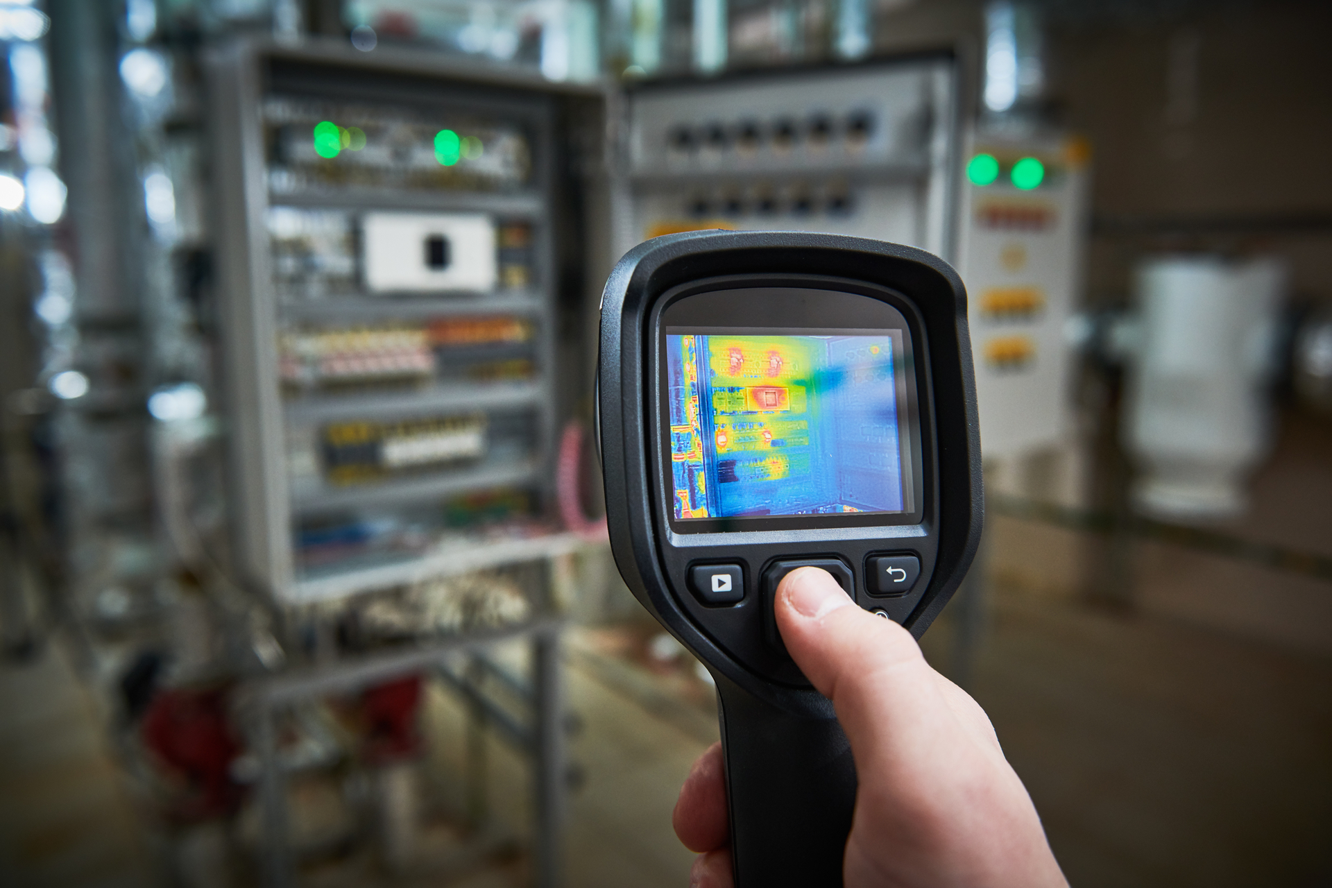

Tim, a thermographer, arrived at the plant of a new client, ready to perform a series of thermographic scans. As Tim and his escort, Greg, walked to the first feeder panel, he noticed black dust from a rubber-like material processed in the plant covering everything, although there didn’t seem to be airborne particulates at the time.
That feeder panel was also covered in the same dust. When Greg started to open the panel, Tim stopped him. “We need to brush and vacuum all this dust off before opening the panel,” he said. Greg replied, “Oh, that’s normal. We just work around it.”
But in what sense was it normal? There is a difference between normally being sloppy and conforming to the conditions expected for normal operation and maintenance of the equipment.
A normal operating condition is required for performing energized work under normal precautions. If you don’t have a normal operating condition, you must assume each possible danger exists unless you can rule it out.
Thermography is performed while equipment is energized, and this situation puts Tim in a bind.
