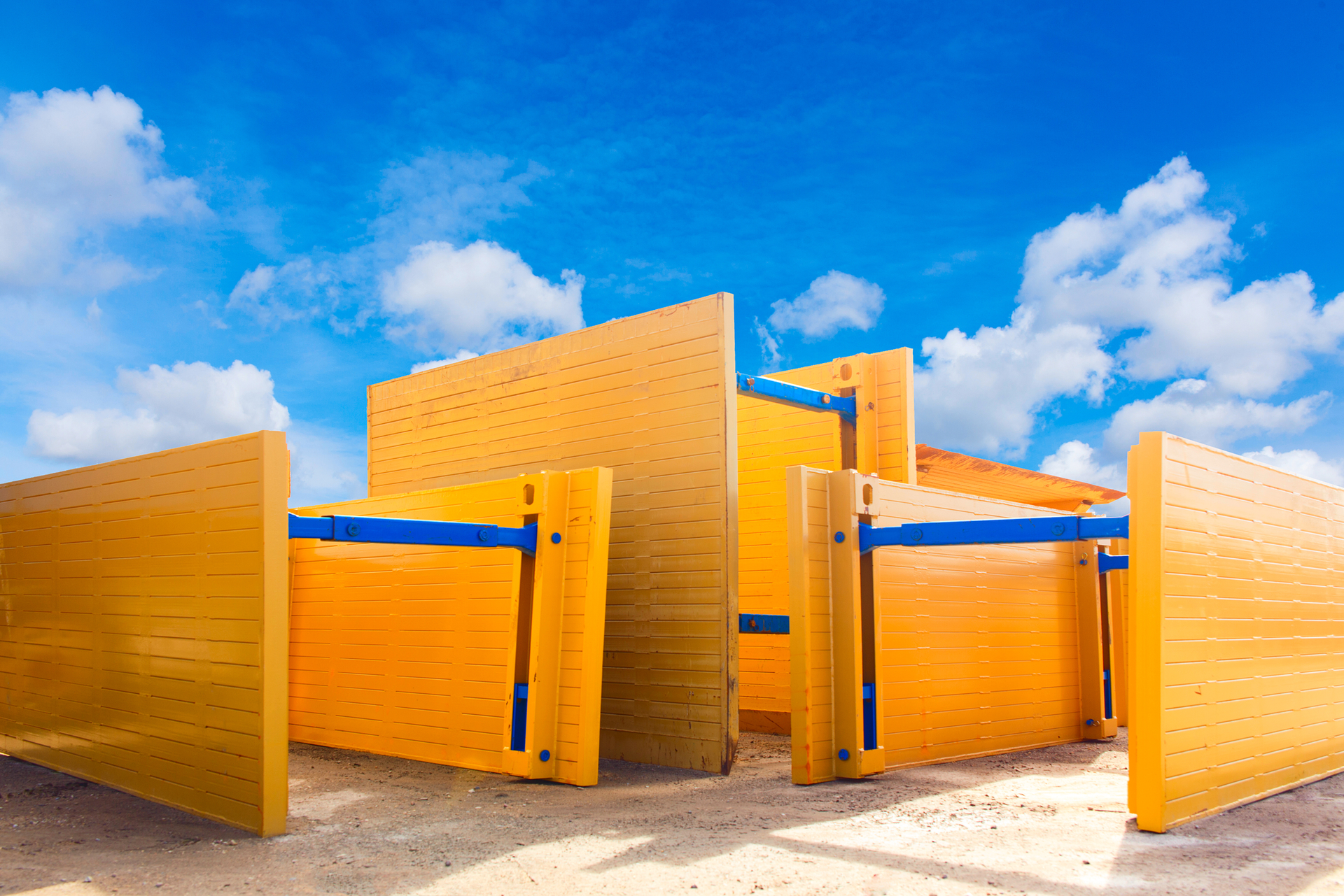

A recent incident in central Texas highlights the dangers of trenching and an impetus for OSHA’s action. On June 28, 2022, two workers, aged 20 and 39, suffered fatal injuries in Jarrell, Texas, when the unprotected trench more than 20-ft deep collapsed upon them as they worked. Trench shields, which could have saved their lives, sat unused beside the excavation.
Trench, excavation requirements
Trenching and excavation operations require protective systems and inspections before workers can enter. When employers fail to install trench protection systems or properly inspect the trench, workers are exposed to serious hazards, including risk of being buried under thousands of pounds of soil. By some estimates, a cubic yard of soil can weigh as much as 3,000 lb, equal to that of a compact car.
States that operate their own Occupational Safety and Health plan have similar emphasis programs in place, and OSHA also encourages those states to consider additional measures, including criminal referrals for federal or state prosecution for trenching-related incidents.
Trenching standards require protective systems on trenches deeper than 5 ft; soil and other materials must be kept at least 2 ft from the edge of a trench. Additionally, trenches must be inspected by a knowledgeable person, be free of standing water and atmospheric hazards, and have a safe means of entering and exiting prior to allowing a worker to enter.
