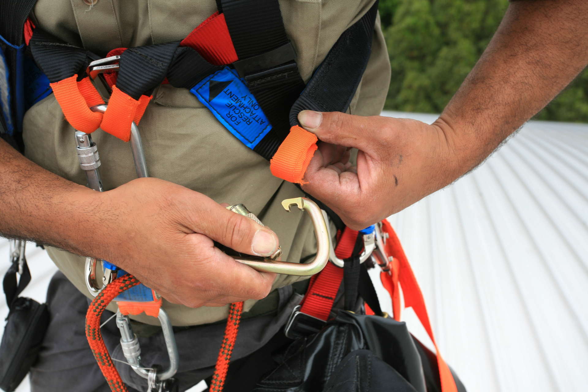

Maybe installing a guardrail there is not feasible. Or the work needs to be done now and there’s no time to install a guardrail first. A safety net system or a personal fall arrest system would protect the employee while also satisfying the OSHA requirement. Notice the order there: Think first of how to protect the employee.

Also, consider the fact that OSHA usually won’t fine a company if the fall height is less than 6 ft, even though somebody can fatally fall from a lesser height. And maybe they won’t fine the company if personal fall protection was used but it had already taken several hard falls and was more than five years old. Who really wins if a fine is avoided, but someone is seriously or fatally injured? What if that someone is you?

  • Provide PPE as a supplement to other measures or as a last resort. Many people jump right to using PPE, but itis the weakest form of protection.
