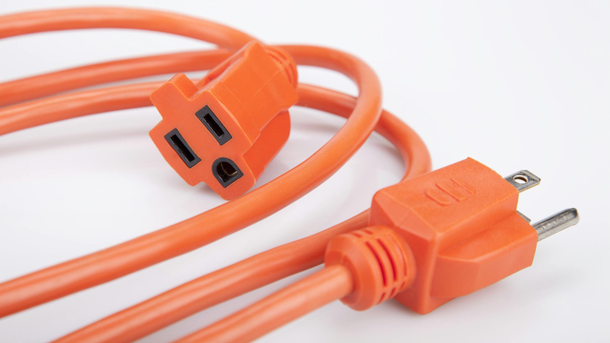

Portable cords aren’t going away anytime soon. They have long been a critical part of maintenance and construction work, and when treated properly, they are reliably safe. So how should you treat them? Here are some tips.
  1. If you’re working around oil or water, use a cord that’s rated for such an environment. Oil itself can degrade the insulation, causing damage you might not see. Cords labeled for wet usage are tested for that environment, and they give you the desired protection because they are designed to pass the test.
  2. Never walk on it. This breaks down the insulation.
  3. Never clean it with a petroleum-based solvent or any kind of oil (light or otherwise).
  4. Where practical, route it away from walkways and lift truck paths. Where not practical, use cord trees to route it over such paths. If you use cord trees, ensure they are tall enough to prevent the cord from contacting pedestrians or vehicles below.
  5. Run it along the side of steps, rather than across them. Don’t be afraid to use tape to secure it in place. If you must run across a step, push the cord all the way to the back, and secure it with tape.
  6. Don’t use staples, saddle clamps, or similar (which are meant for permanent use) to secure your portable cord. Secure it to devices designed for portable cord routing, not to the building structure and not to any piping or raceway.
  7. If you use wire ties to secure portable cord, ensure you don’t bite into — or even compress — the cord jacket. Barely snug them.
  8. Don’t repair a damaged cord. Yes, you can cut off the damaged part and install a new plug. But don’t attempt to fix a damaged cord jacket with tape or other means. You simply cannot produce a safe cord this way.
