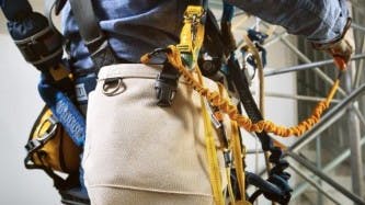

What are tool tethers?
Tool tethers are designed to prevent objects from falling. They are used to attach various tools to an anchor point much like a fall arrest system for workers on elevated surfaces. The tether catches the tool if it slips out of the worker’s hand and prevents it from reaching the ground or floor below.
All tool tethers must be securely attached to the tool using a carabiner and D-ring. If the tool comes with a D-ring, it is considered “tether-ready.” Other attachment points include quick spin and quick ring attachments, D-ring cords, D-ring and quick-wrap tape, and tool cinch attachments. The tool should at least have a hole where the tether can attach; otherwise, it might not be safe to use when working at height.
The other end of the tether attaches to an anchor point, either on the worker’s body or the nearby structure. If the tool weighs over five pounds, it should be anchored off the body, such as the wall or railing. If the tool weighs five pounds or less, it can be attached to the worker’s tool belt, belt loops, holsters, or wristband. This helps the worker stay mobile in the field. If the tools need to be mounted off the body, they should be kept in a central location where the work is performed.
There are two types of tool tethers: rigid (or fixed-length) tool tethers and elastic (or extendable) tethers. Rigid tool tethers have a set length, and there is no fall arrest system to prevent the tool from swaying back and forth. Elastic tethers use shock absorption to slow the tool’s fall, which helps it come to a complete stop.
Both options prevent the tools from falling, but elastic tethers are typically the best choice for working at height. They make it easier for workers to collect fallen tools by limiting unnecessary movement. Heavy power tools can sway like pendulums if they have enough velocity, which can be dangerous in certain situations. The sudden jolt of a fall can also put pressure on fixed lanyards, making them more likely to fray.
