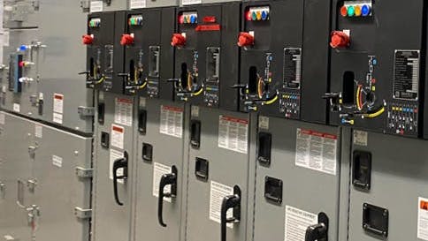

Racking in or out a power circuit breaker is simple, right? Although this task sounds pretty straightforward in theory, that’s not always the case. In fact, during years of field work related to external electrical safety audits or while completing practical hands-on electrical safety program training in my electrical safety consulting practice, in general, I have found a lack of adequate formal training for “qualified persons” with new or updated electrical equipment technology related to power distribution electrical equipment.
Specifically, when capital project teams had successfully procured both low- and high-voltage arc-resistant electrical equipment, no formal training was typically provided. Where low- and high-voltage switchgear power circuit breakers had been provided, there was a lack of awareness of updated design elements related to manual racking or onboard remote racking (i.e., emergency extraction). Lastly, related to new high-voltage arc-resistant electrical equipment (i.e., switchgear) with embedded high-voltage motor starters, there was a lack of awareness of arc-resistant electrical equipment/type (e.g., IEEE C37.20.7 and specific Types) and for a high-voltage motor starter isolation a confusing mimic display on each motor starter where no formal training or procedure was in place.
Qualified persons (low-voltage and high-voltage qualified) were often not effectively trained concerning the isolation of new low- and high-voltage electrical power distribution equipment. Gaps in knowledge and a lack of competency on how to rack out or in a low-voltage power circuit breaker, how to complete a required “emergency extraction” racking out of a normally remotely racked high-voltage power circuit breaker when the onboard remote racking system fails, and isolation of a unique high-voltage motor starter were identified.
Is racking out or in a low- or high-voltage power circuit breaker simple? What about isolating a high-voltage motor starter? Are Kirk key interlocks involved? How many turns does it take to rack to “test,” and then how many additional turns to rack to “disconnected?” Are there special buttons the qualified person must push?
A critical component of risk related to the likelihood of occurrence related to energized electrical work tasks is ensuring the qualified person has the appropriate skills, knowledge, experience, and competency to perform the work. The employer must manage human performance and address the likelihood of human error. Racking out or in low- or high-voltage power circuit breakers and isolating unique high-voltage motor starters is not necessarily intuitive and simple. Qualified persons shall be suitably trained, follow a procedure, and have their competency validated before performing this type of work.
In the last decade, manufacturers have brought innovation to the industry with electrical equipment based on the concept of “safety by design/prevention through design (PtD)” related to the hierarchy of risk control methods to apply to an abnormal arcing fault and arc flash/electric shock. This has significantly benefitted the reduction of risk exposure to an abnormal arcing fault, arc flash, and electric shock. But has the qualified person received adequate training on this new electrical equipment? Do they make assumptions based on previous experience?
Depending on the manufacturer of low- or high-voltage power circuit breakers, this equipment may now have new unique interlocks. It may no longer be as simple as inserting the racking tool and racking the power circuit breaker out or in.
For high-voltage switchgear and power circuit breaker racking that has a provision for onboard racking only (with no through-door racking normally provided), what happens if this automated system fails? Has the qualified person been effectively trained to manually rack in and out the breaker? Is the manual “emergency extraction” racking simple? Is it the same as all the other power circuit breakers the qualified person has racked in or out in the past?
