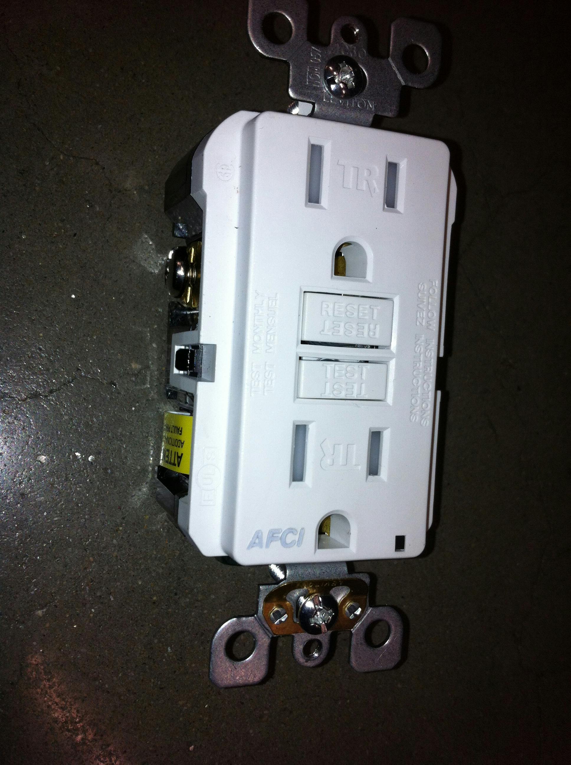

  • A listed branch/feeder-type AFCI shall be installed at the origin of the branch circuit in combination with a listed outlet branch-circuit-type arc-fault circuit interrupter at the first outlet box on the branch circuit. The first outlet box in the branch circuit shall be marked to indicate that it is the first outlet of the circuit per Sec. 210.12(A)(2).
  • A listed supplemental arc protection circuit breaker shall be installed at the origin of the branch circuit in combination with a listed outlet branch-circuit-type arc-fault circuit interrupter installed at the first outlet box on the branch circuit where all the following conditions are met, as noted in Sec. 210.12(A)(3).
  • The branch-circuit wiring shall be continuous from the branch-circuit overcurrent device to the outlet branch-circuit arc-fault circuit interrupter as described in Sec. 210.12(A)(3)(a).
  • The maximum length of the branch-circuit wiring from the branch-circuit overcurrent device to the first outlet shall not exceed 50 ft for a 14 AWG conductor or 70 ft for a 12 AWG conductor per Sec. 210.12(A)(3)(b).
  • The first outlet box in the branch circuit shall be marked to indicate that it is the first outlet of the circuit per Sec. 210.12(A)(3)(c).
