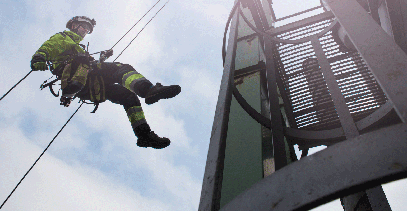

    Fall protection. This breaks down into two major categories: Fall arrest (catch you once you fall) and fall restraint (keep you from falling). Examples of fall restraint include platform railings, tape barriers, and ladder cages. Our focus will be on fall arrest, specifically the harness/lanyard PPE worn while at elevation.
    Fall arrest
    As the name implies, this is equipment that arrests your body once you fall. Typically, this means a harness and lanyard. You clip one end of the lanyard to your harness, and the other end to an anchor point. This system has many points of failure that you must address if you are to be safe while depending on it. Start by examining the work area for anchor points.

    Repeat the harness check, with special attention on the buckles, before every ascent even if you don’t remove the harness. This is standard protocol in rock climbing; make sure you follow it in industrial climbing.
