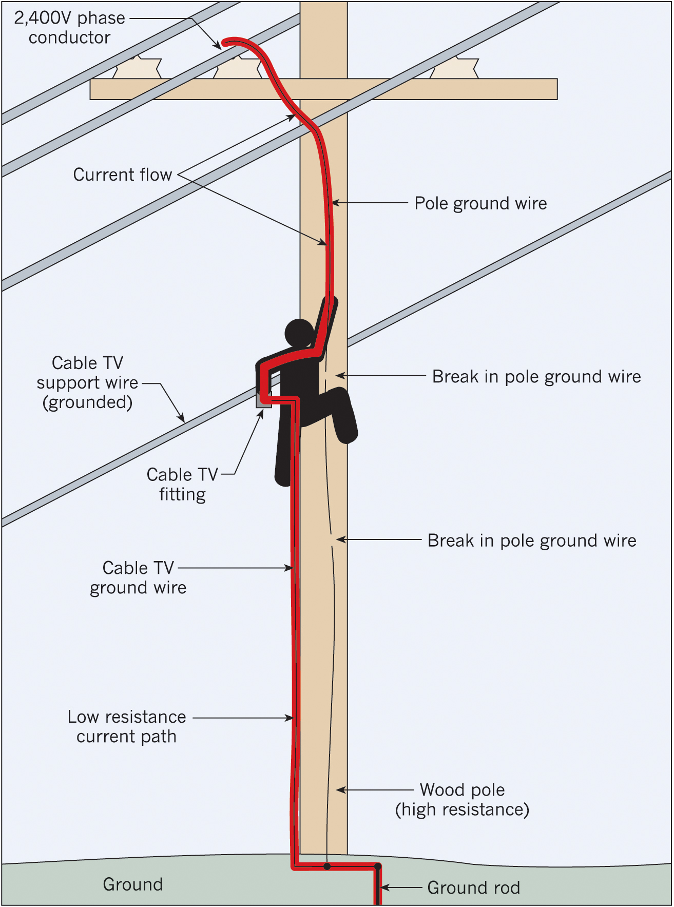

The heavy red line depicts the current path that ultimately killed a cable television technician.
The Case of the Deadly Ground Wire

The Scene
The setting of this tragic accident occurred at an electric utility pole, similar to the one depicted in the Figure below. The technician was standing near the top of a ladder (the ladder is not shown so you can more clearly see the current path). On the left side of the pole, you see a cable TV wire and fitting attached to a grounded steel support wire. The fiberglass ladder was leaning against the wood pole. Even if a person stood on the top rung of the ladder, he would still be clear of the electric utility power conductors at the top of the pole.

Examination of the Pole
An examination of the wood pole by electric utility personnel revealed that a ground wire ran up the east side of the pole from the ground level. However, as the investigating utility electrician followed the ground wire up the pole, he realized it had been cut in two places — 6 ft and 10 ft above ground level — and that the top portion of the wire was hanging in mid air (less than ¼ in. away from the 2,400V phase conductor at the top of the pole).
At the time of his inspection, the electrician noted current was “jumping across” from the live phase conductor to the end of the ground wire. He measured approximately 880V between the ground wire on the pole and the steel wire supporting the TV cable. He concluded that the energized phase conductor had induced the 880V on the ground wire due to its close proximity. In addition, he noted the steel wire supporting the TV cable and fitting registered 0V — as it should have, due to the fact that it was grounded.
A comparison of the location and routing of the ground wire on this pole with the ground wire configuration of a standard pole revealed that someone at the electric utility had removed the static wire connection at the top of this pole to make room for an additional phase circuit. However, the timing of this event remained unknown.

Accident Reconstruction
Based on the evidence, I came up with the following conclusions regarding how the accident played out. The cable TV technician climbed up his fiberglass ladder, which was resting against the west side of the electric utility pole, to remove the filter from the TV cable fitting supported from the pole. Because the fitting was above the end of the ladder, he would have had to reach up and out to work on it. He most likely steadied himself against the pole by reaching around it with one hand as he reached out with his other hand to the TV cable fitting to remove the filter. When he had difficulty removing the filter, he probably reached further around the pole to better steady himself. It was at this point that he must have made contact with the energized ground wire, which carried some voltage (880V or higher, depending on how close the loose ground wire at the top of the pole was to the energized phase conductor).
The pattern of burns on the victim’s hand were consistent with placing the hand at almost a 45° angle with the vertical against the pole covering the ground wire, as one would do to steady oneself. This would have placed his upper body in the current path between the energized ground wire and the grounded cable TV support cable. The passage of current through his body either caused his death or caused him to fall to his death (see Electrical Circuit Phenomena on page 10). The location of his body, as found on the ground at the base of the pole, was consistent with him leaning out (to the north) to work on the cable fitting. An examination of the deceased’s hands showed no evidence that he had attempted to break his fall, indicating that he was either dead or unconscious prior to hitting the ground.

SIDEBAR:Electrical Circuit Phenomena
Because the ground wire was not connected to ground and cut in two places, the connection between the end of the ground wire above the cut section and the ground was through the wood pole. The dry wood (the weather was dry at the time of the accident) in the pole presented a high resistance to electric current so that very little current flowed via this path. In other words, not enough current flowed to cause the protective devices that protected the power circuit to trip and interrupt the current. Thus, the arc between the phase conductor and the ground wire could have continued indefinitely. Had the ground wire not been cut in two places, it would have provided a safe path to ground and should have tripped protective devices.
As shown in the first Figure above, when the victim contacted the energized ground wire above the cut sections and the grounded cable support wire at the same time, the current flowed into his hand touching the energized ground wire, through his body, out his other hand to the cable TV support cable, and then through the cable TV ground wire to ground. The burn marks on his hands confirmed this path.
The resistance of the human body for electrical safety purposes is considered to be about 1,000 ohms, according to IEEE Std 80-2000. Before the switch is closed in the above circuit, simulating a person contacting the energized ground wire while being grounded through the cable TV support cable, the voltage across the resistance representing the wood pole is about 880V, as measured by the electric utility. When the switch is closed, the body resistance shorts out the wood pole resistance, because it is so much smaller in value, which allows current to flow through the body. When this happens, the voltage across the body resistance will drop from whatever the open-circuit voltage on the ground wire was (880V or higher) to a lower value due to the higher current flow from the source through the body resistance (see Figure below). It only takes about 70mA to 300mA of current to kill a human. Thus, it only takes about 70V to 300V to cause a potentially fatal current to flow in the body.
