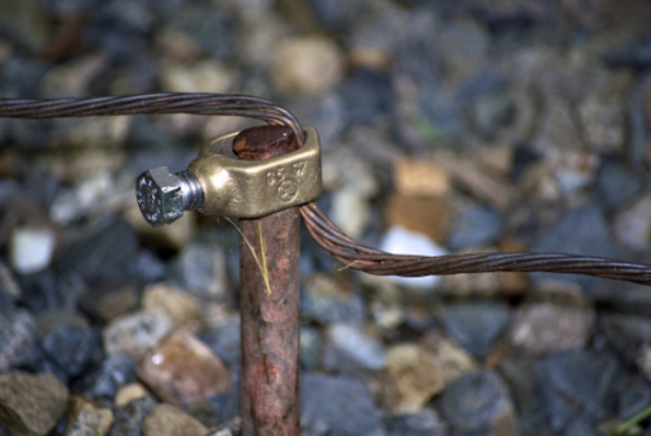

Often, the “solution” is to drive ground rods everywhere. A motor failed, no problem; we prevent that by driving a ground rod through our nice factory floor and bolting it up. The sad truth is that this response accomplishes nothing. The soil resistivity is just too high to create an effective low impedance path back to the source.
Another “solution” is to install surge protection at the service. This will, if properly designed, reduce incoming surges, but it does not protect against the most common source of high voltage transients. That source is equipment inside the plant. A typical culprit is a large motor that starts across the line. A good solution for that problem is to install a soft start for that motor.
Soft starts on large motors may not stop all sources of load side transients, however. If that’s your situation, then a surge suppression system is needed. But consider your system carefully, understanding that a given surge device will reduce the transient voltage only so much. Think of a series of voltage reductions, and design a tiered system accordingly.
And, yes, of course you want to ensure all non-current-carrying metallic objects are bonded as required by Art. 250, Part V of the National Electrical Code (NEC).
