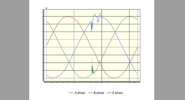

These random transient voltages (i.e., waveform notching) were recorded at a 480V service entrance with a power monitor.
You can’t hook up a digital multimeter (DMM) and have it look backward in time to measure an event that already happened. The only way to know if an event happened is to look at measurements that have been recorded. You want to do this with something more than the high-low recording feature on a DMM. For one thing, that DMM can’t tell you how many transient events it saw (if, indeed, it was fast enough to capture any).
You need something that is fast enough to capture each transient event, and you need something that will tell you when each occurred and how long it lasted. It would be nice to know not only the magnitude of each transient but also what its waveform looked like.
A power monitor fits the bill. It’s unlikely you can have it watch all of your motors, but you can have it watch your critical motor feeders.
