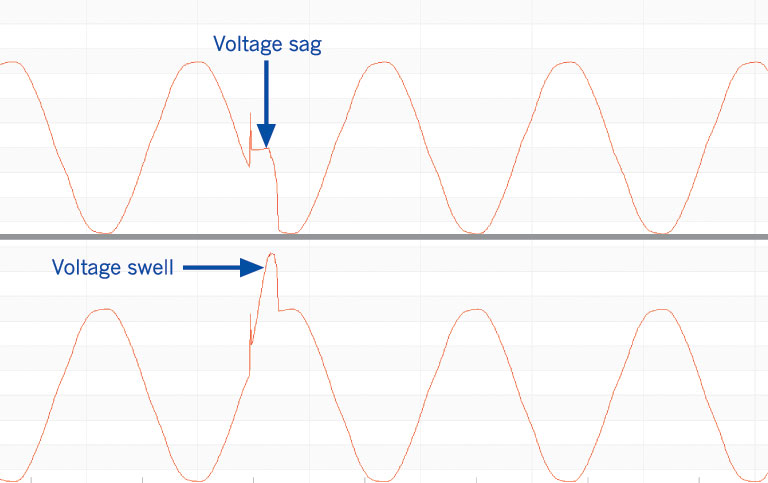

The fundamentals of voltage movements with a loose neutral are the same when viewing raw waveforms, but the presentation is different. With RMS values in the strip chart, a voltage sag is always a decrease in value, while a swell is an increase in value. With the instantaneous values of the sine wave, the specific direction of the voltage shift depends on which half of the voltage waveform is affected. On a point-by-point basis, the subtracted difference of one leg from the other at any specific point during the loose neutral is constant compared to the difference at the same point on the waveform during other cycles. Figure 3 shows an example of an open neutral waveform capture.
Fig. 3. Sub-cycle open neutral in waveform capture, showing CH1 voltage dropping and CH2 voltage rising.
Here, most of the load is on Channel 1 and almost none on Channel 2. Consequently, the voltage on Channel 1 drops almost to zero, while Channel 2 increases to virtually the entire transformer output (240V RMS). The open only persists for 2.7 msec — less than a quarter of a cycle. The “one leg rises, one falls” is more complex in the waveform view. For a leg to “fall,” it must go closer to zero volts. Depending on the point on the waveform where the event starts, this could mean rising on the graph from a negative value toward zero or falling from a positive value. In Fig. 3, Channel 1 “falls” from negative voltage up to almost zero volts. To “rise,” a leg must increase in magnitude — further either in the positive or negative direction. Here Channel 2 rises by increasing from a positive starting point. If this event had happened in the negative half of Channel 2’s waveform, the “rise” would have been downward toward a more negative value.

This relationship holds true during a loose or open neutral. In Fig. 5, the event from Fig. 3 is analyzed in more detail.
Fig. 5. Open neutral event from Fig. 3 showing that L1(t) + L2(t) is unchanged during the event.
The point table is shown at a specific sample during the event. At point 713, or 46.53 msec, L1 is -0.8V, and L2 283.9V. Subtracting those values yields -290.7V for the full transformer output. Looking one cycle later (after the event), same point on the sine wave is at 63.02 msec. Here, L1 is -142.2V, and L2 is 142.3V. Both channels are equal and opposite, as expected. Subtracting L1 from L2 results in -142.2 - 142.3 = 284.5V, roughly the same as the 283.9V during the loose neutral event. Here, the criteria of one channel rising, one channel falling, and the difference remaining the same is met, indicating a loose neutral event. During the event, Channel 1 is mostly flat near zero volts (held there due to the low impedance of its load compared to Channel 2). Consequently, Channel 2’s shape is that of a 240VAC sine wave, since numerically both channels must sum to that waveform.
