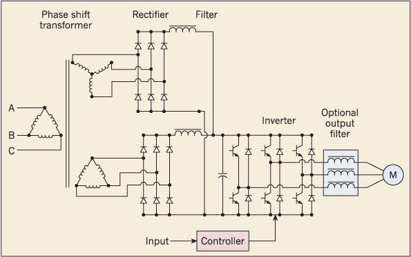

A 12-pulse VFD has phase shift transformers ahead of 6-pulse VFD to cancel the harmonics reflected back to the source. The phase shift transformers can be tuned to reduce harmonic distortion to less than 10% at the input terminals of the VFD
