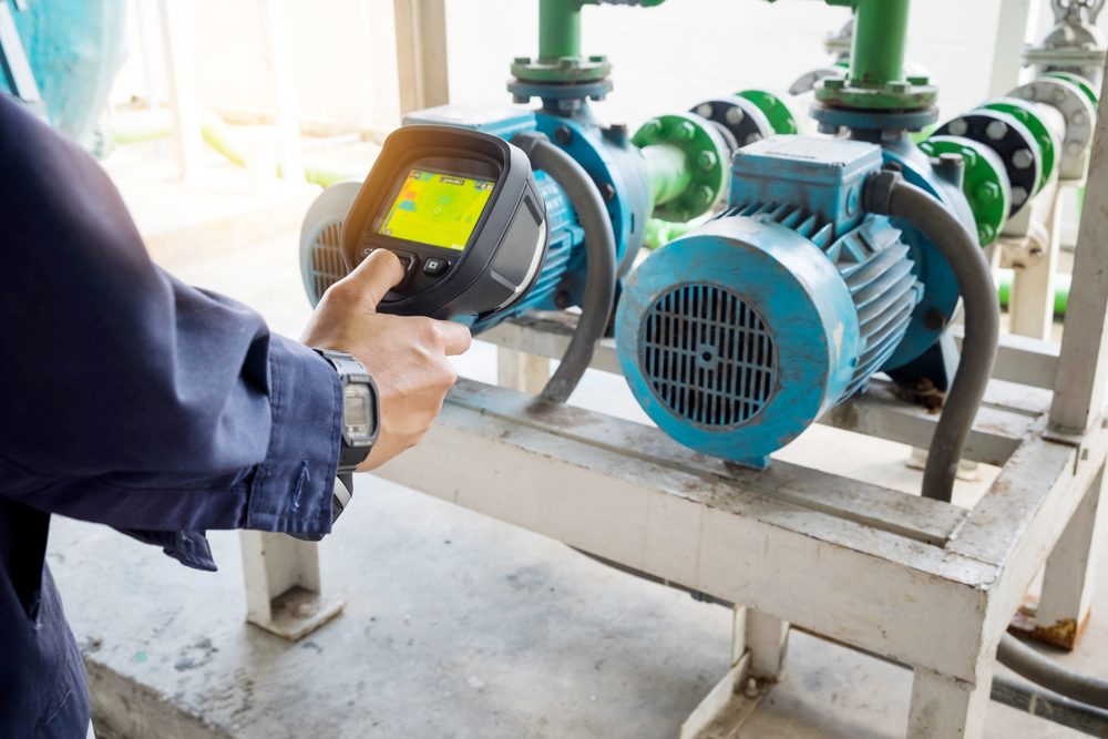

  • High-resistance terminations, which convert electrical energy into waste heat. The cause of these is nearly always poor workmanship.
    Solution: Set up a torque tool program, train the users on the fundamentals of fasteners (never over-tighten, don’t re-use, etc.), and use a thermography program to efficiently spot suspect (heat-emanating) connections.
