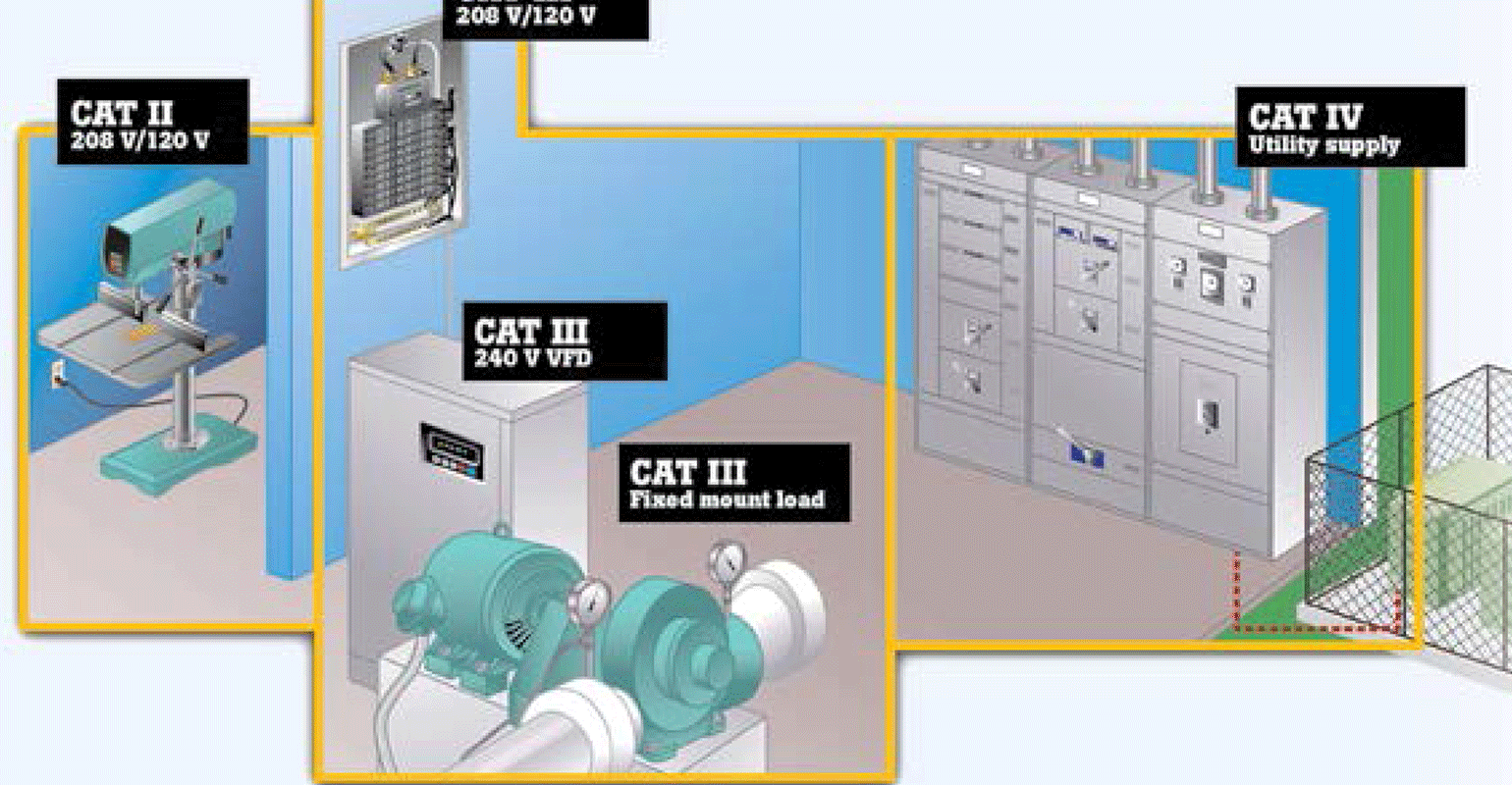

What CAT rating is required for your environment?
The International Electrotechnical Commission (IEC) publishes standards for all electrical, electronic, and related technologies. The most important thing to understand about the IEC safety standards is the “measurement category.” Make sure that any meter you consider has an IEC Category (CAT) rating that is appropriate for the electrical environment in which you will use it.
The CAT rating typically appears near the multimeter input jacks. Multimeters that are not CAT rated should never be used in high energy, 3-phase electrical work environments. Be sure that the test leads you use with the meter have an equal or greater CAT rating as well. The categories related to commercial and industrial work are noted in Table 1.
It is important to consider both the CAT rating and the voltage rating. For example, a CAT III 1,000V meter offers superior protection to a CAT III 600V rated meter, but a CAT II 1,000V rated meter is not superior to a CAT III 600V rated meter. That is because in calculating the voltage-withstand ratings, IEC 61010-1 test procedures take into account steady-state voltage, peak impulse transient voltage, and source impedance. Table 2 shows those values in context with the various CAT ratings.

A final note. If you are looking to replace your multimeter, start by analyzing the worse-case scenario for your job, and choose the measurement category for that scenario (Fig. 2). Then choose a meter rated for that measurement category with the highest voltage rating you will need within that category.
