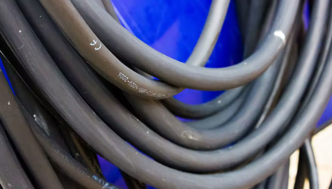

Article 400 — Flexible Cords and Cables
This handy Article covers the specific uses of cords and cables that can prevent the transmission of noise and vibration to general-use appliances and electrical equipment. When tools or equipment must be fastened in place (and permit the ready removal for maintenance and repair of mechanical connections and moving parts), use the handy cords and cables listed in this Article. In addition, these cables are used to distribute power to lamps, elevators, vacuum cleaners, electric heaters, portable power tools, stage lighting and power, electric ranges and dryers, cords used for hard service, and electric vehicle charging stations.
Art. 400 also provides the following information for cables and cords in Table 400.4:
  • Cable voltage limitations;
  • Description of the outer covering(s);
  • Available conductor sizes and gauges;
  • Applications and uses permitted for each cord and cable;
  • The number of conductors available in a flexible cord or cable; and
  • Trade names for cables and cords with their abbreviation or designation letters.
Do’s and don’ts for flexible cables
Keep a few things in mind when selecting cables found in Art. 400. First, flexible cords and cables shall not be used as a substitute for the fixed wiring of a building or structure. Those materials are covered in Chapter 3, Wiring methods, which covers the building stage of construction projects.
Do not run these cables through holes in walls; above structural, suspended, dropped ceilings; or floors. They cannot be concealed by walls, floors, or ceilings or run through doorways or windows. Be mindful not to locate them where they will be subject to physical damage. If you must attach any of these cables to a building surface, follow the provisions of Sec. 368.56(B) Exception 1 through 4.
