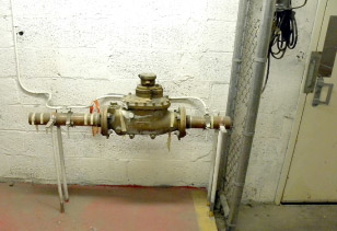

Now That's One Hefty Grounding Electrode
This photo was taken at a shopping mall where the water service had been relocated by the local waterworks company. However, it seems clear that those involved with the project did not have any background in electrical design or installation. As a result, even though they removed the water pipe electrode, they dutifully left the water meter and the grounding electrode conductor attached to the building and street side of the water meter. It's hard to imagine what they thought this connection was all about, but it seems they felt that as long as they didn't remove it everything would be hunky-dory.
I don't believe that Code Making Panel 5, the panel responsible for overseeing the requirements of Art. 250, had such an occurrence in mind when they removed the reference to 250.52(A)(1) in 250.52(A)(2)(2) in the 2008 NEC. In fact, the concern was related to the reality that more and more city water systems are changing over to nonmetallic piping, essentially eliminating the earth connection, which is required to provide for lightning discharge and voltage stabilization.
In the 2005 edition of the NEC, 250.52(A)(2) recognized ungrounded building steel as being grounded where it was connected to a water-pipe electrode. And, where such a connection was provided, the building steel could be considered as supplementing the water-pipe electrode, which is required by 250.53(D)(2). However, the elimination of the reference in 250.52(A)(2) to 250.52(A)(1) effectively eliminates the possibility of using the water-pipe electrode to ground the ungrounded building steel and then use the now-grounded building steel to supplement the water-pipe electrode.
It should be noted that as given in 250.104(C), where ungrounded exposed building steel is likely to become energized, it must be bonded to any one of several locations in the grounding electrode system. The last location identified in this section is “one or more grounding electrodes used,” which would include the water-pipe electrode. So, for compliance with 250.104(C), it is still permissible to use the water pipe, but it's no longer permissible to supplement the water pipe by connection to ungrounded building steel.
