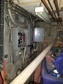

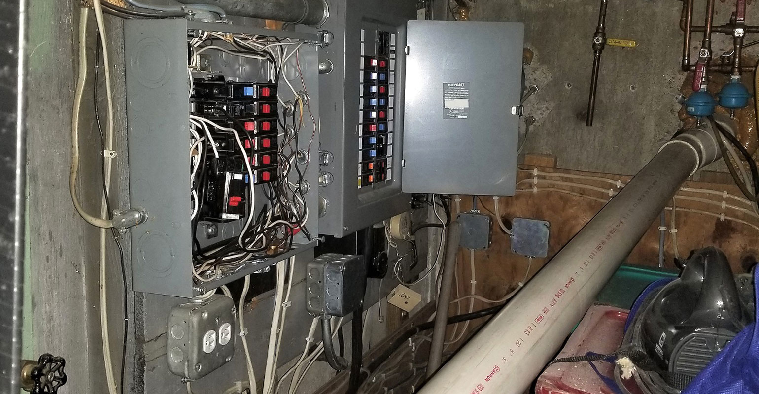

The Great Divide
This fantastic photo was shared by one of my electrician students who prefers to remain anonymous. In the words of this student, “This house had three panels in that alley that were divided by that drain. Also, if you notice on the left side, there was a breaker hanging out of the panel that was still attached to a wire.” There are lots of problems we need to discuss here.
The one jumping out at me is the white PVC drain pipe and storage items installed directly in the working space required by Sec. 110.26(A). How can something like this happen? These panelboards and overcurrent devices are nearly impossible to reach now. The missing panelboard cover creates a dangerous shock and fire hazard too. Section 110.27(A) requires the live parts in this panelboard to be guarded against accidental contact by being enclosed in a cabinet with the cover installed. Section 110.18 requires any arcing parts of electrical equipment, such as overcurrent devices, to be enclosed or separated and isolated from any combustible materials. In the words of my student, “This appears to be another happy homeowner renovation.” I agree with that assumption.
