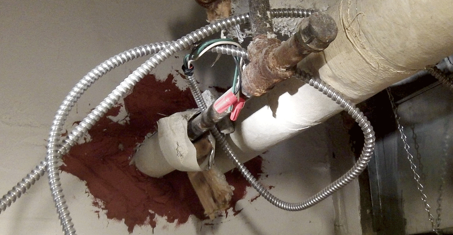

Better Call the Terminator to Fix this Mess
It’s always frustrating and scary when I find stuff like this hidden above a suspended ceiling. Who would think this was a good idea? This unsecured but energized MC cable was just thrown up on top of some pipes above the ceiling. Leaving energized conductors exposed like this can be a very dangerous practice. An unsuspecting worker could easily grab this cable, thinking it was abandoned or de-energized. That could end up being a deadly mistake. While there is no Code rule requiring all abandoned wiring to be removed, there is a requirement in Sec. 300.15 that requires a box or conduit body to be installed where conductors are terminated in Chapter 3 wiring methods such as this MC cable. Installing the end of this MC cable into a box that has a cover and is properly secured in accordance with any of the provisions of Sec. 314.23 would go a long way toward making this a much safer installation. There are provisions for temporary power installations in Sec. 590.4(G) that allow splices to be made on construction sites without the use of a box. However, this photo was taken at an occupied building — not at a construction site.
