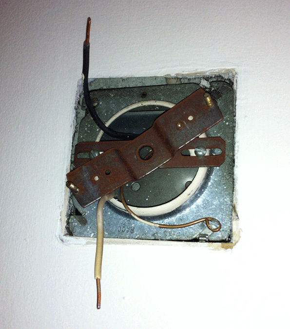

You never quite know what you’re going to find when you’re doing repair or replacement work. This is what I discovered when I removed the luminaire attached to this box for the purpose of installing a new fixture.
The equipment grounding conductor was attached to the 8/32 cover screw instead of being attached to a grounding screw “used for no other purpose,” as required by Sec. 250.148(C). Instead, this installer took a shortcut and created a Code violation. A grounding clip or other equipment listed for grounding could have also been used to attach the equipment ground wire to the metal box.
Another related requirement is Sec. 410.44, which requires metal luminaires to be “mechanically connected to an equipment grounding conductor.” Also, luminaires with exposed metal parts must be provided with a means for connecting an equipment ground wire to such luminares, as required in Sec. 410.46.
To ensure proper grounding for this installation, I removed the ground wire from the 8/32 cover screw. I then installed a grounding screw in the box, attached a grounding “‘pigtail” to that screw, and connected the equipment ground wire from the fixture and the branch circuit wire together with a wire connector. The wall surface was gypsum wall board so there was no concern about covering any combustible material between the box and the luminaire canopy as required in Sec. 410.23.
