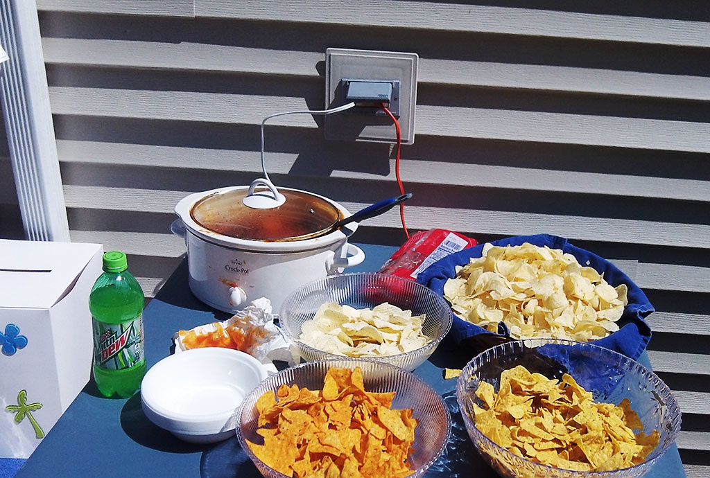

I was at a cookout this summer where I noticed this outdoor receptacle being used. As I grabbed my bowl of snacks, I couldn’t help but notice the cover was not the correct type.
Section 406.9(B)(1) requires 15A and 20A receptacles in wet locations to be installed in an enclosure that is “weatherproof whether or not the attachment plug cap is inserted.” The cover in this photo is weatherproof only when the cords are not plugged in. Using a “bubble cover” would have been a better option for this receptacle. A hood installed for this purpose is required to be listed and identified as “extra duty.”
In addition, the 125V receptacle installed in this outdoor wet location is required to be a listed weather-resistant type device. This requirement also includes 250V receptacles installed in a wet location.
Finally, let’s not forget about Sec. 210.8(A)(3), which requires this dwelling unit receptacle to be provided with GFCI protection since it is located outdoors. Thankfully, this was a GFCI receptacle.
