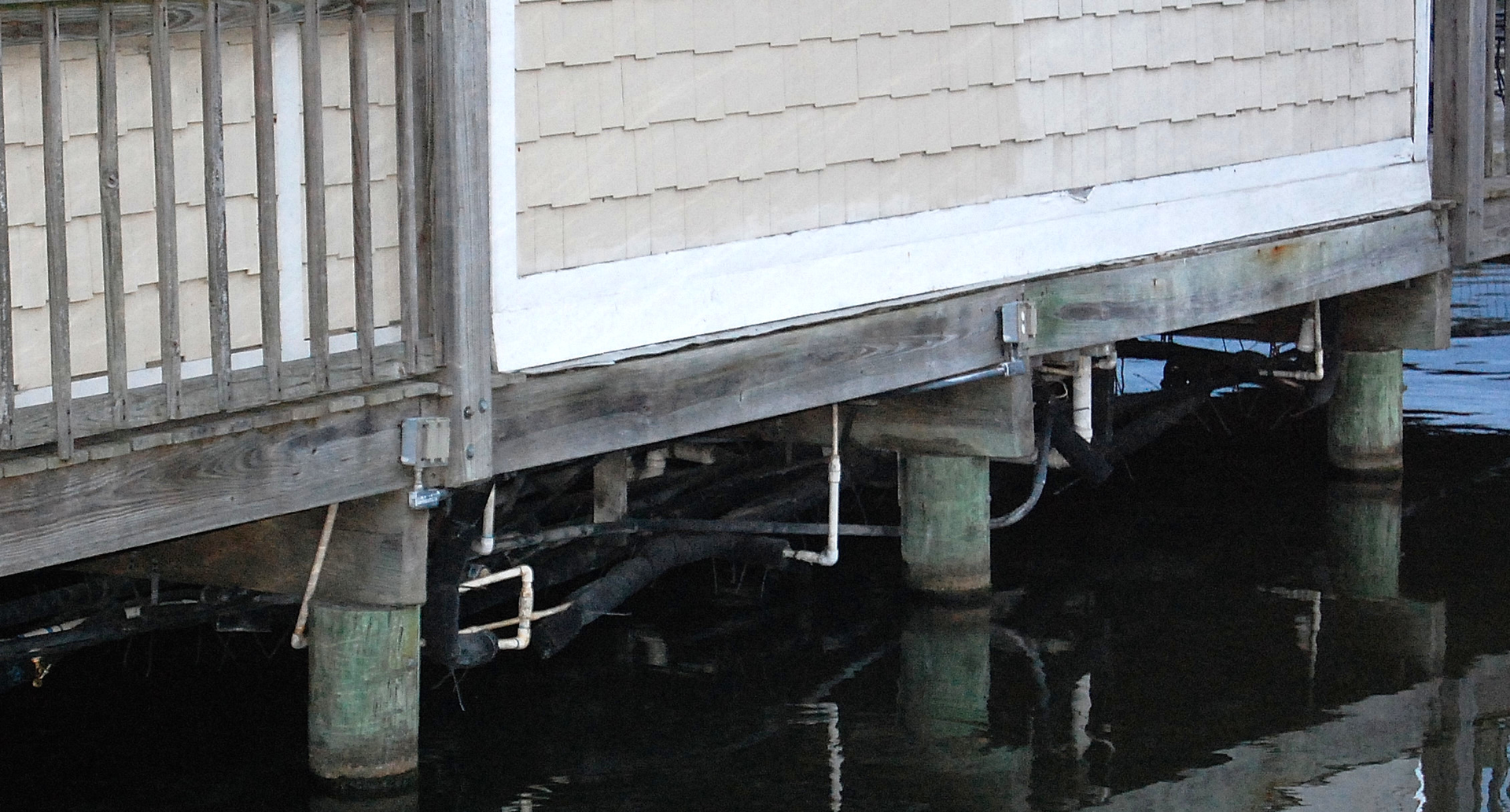

I spotted these receptacles mounted low on the side of this building while cruising around a local harbor on a water shuttle. The type of flip-up covers used on the boxes are only weatherproof when they are closed. One of the flip-up covers on the box on the right is completely broken off. Section 406.9(B)(1) requires covers for 15A and 20A, 125V and 250V receptacles installed in wet locations to be weatherproof whether the attachment plug cap is inserted or not. That same Section also requires any outlet box hoods installed for this purpose to be listed and identified as “extra-duty.” The covers installed here are neither “weatherproof while in use” nor “extra-duty” type. The one broken cover is a good reminder why “extra-duty” type covers must be used in these situations. As their name indicates, “extra-duty” covers are constructed in a manner that makes them better able to withstand the rigors of continually opening and closing the covers.
