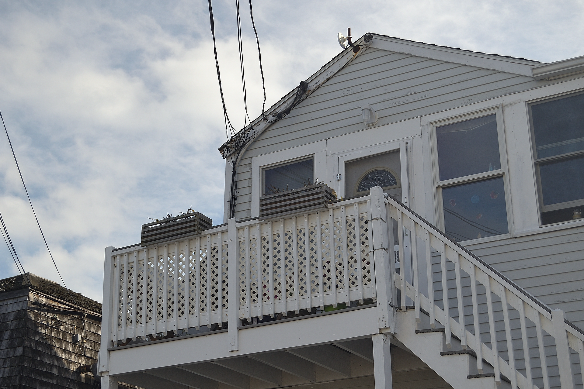

Can you spot the Code violation here?
How well do you know the Code? Think you can spot violations the original installer either ignored or couldn’t identify? Here's your chance to moonlight as an electrical inspector and second-guess someone else's work from the safety of your living room or office. Can you identify the specific Code violation(s) in this photo? Note: Submitted comments must include specific references from the 2020 NEC.
Hint: Too close for comfort

Unfortunately, there were no winners this month. Apparently, nobody knew this is not the correct way to install receptacles in outdoor wet locations.
Section 314.15 requires boxes installed in wet locations to be listed for use in wet locations. This 4-in. square cover is not suitable for use in wet locations. Section 406.9(A) requires this 15A, 125V duplex receptacle to be installed in an enclosure that is weatherproof whether anything is plugged into the receptacles or not. An outlet box hood installed for this purpose would need to be listed and identified as “extra-duty” type. Before this cover was broken, it was only weatherproof when closed. Weather-resistant-type receptacles are also required to be installed here. The broken receptacle face increases the risk of a person receiving a dangerous shock and violates Sec. 110.12(B), as these broken parts adversely affect the safe operation of this equipment.
