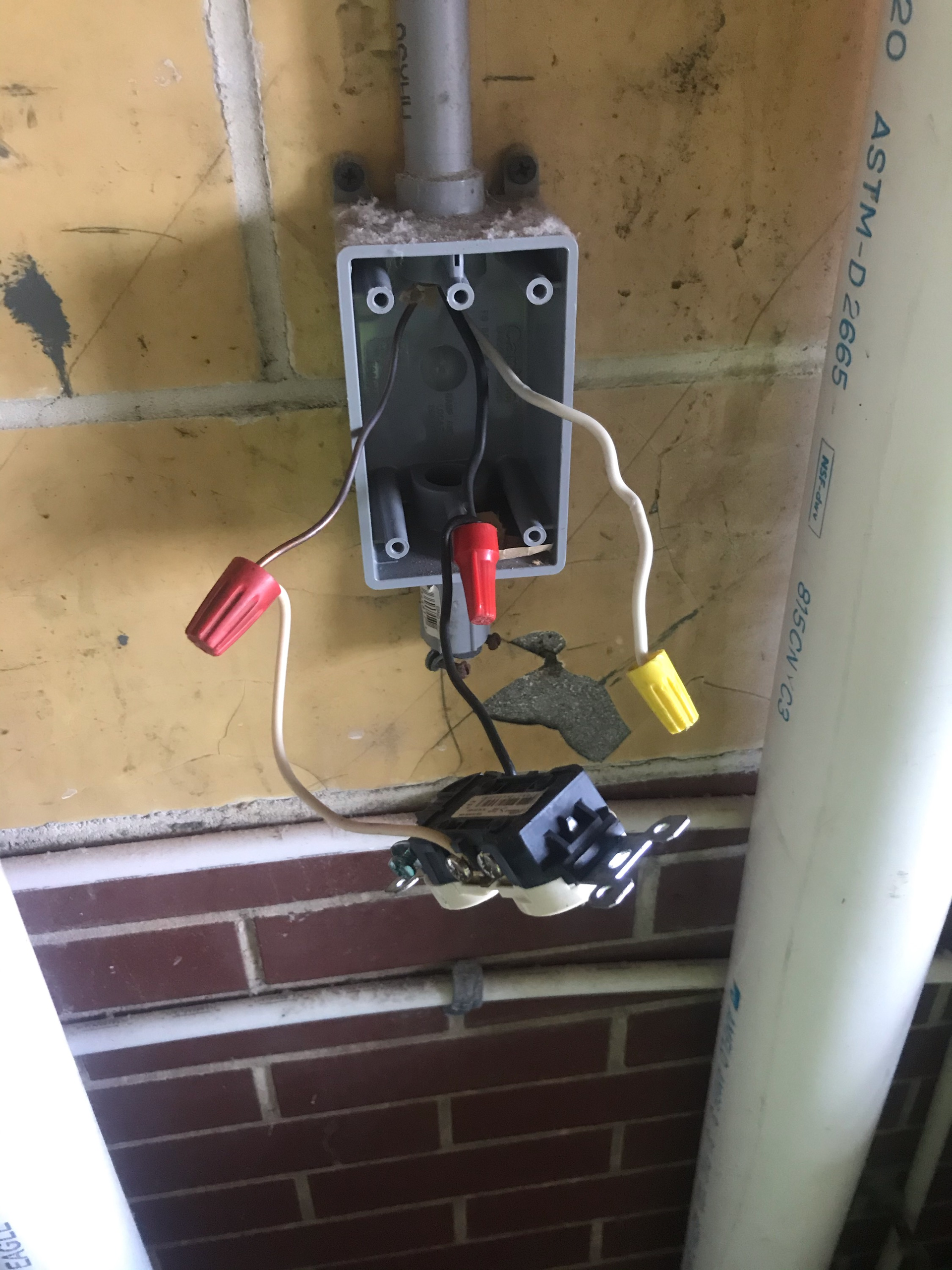

Hint: This installer got their signals crossed.
Here’s another great submission from Stephen Pilling, director of operations for Reilly Electrical Contractors, Inc., in North Hampton, N.H. “This receptacle powered a washing machine in a local motel,” says Pilling.
It disheartens me to think that an installer believed this was compliant and safe. Using the equipment grounding conductor (EGC) in place of the grounded (neutral) conductor leaves any appliance plugged into this receptacle ungrounded, unbonded, and in violation of Sec. 250.4(A)(2) and Sec. 250.4(A)(3). It also creates objectionable current flow on the EGC, which is a violation of Sec. 250.6(A). Using a bare wire in place of the white wire violates Sec. 310.3(D), which generally requires conductors to be insulated unless specifically permitted to be bare. Having the energized wires and receptacle dangling out of the box is an extreme shock hazard and violates Sec. 110.27(A), which requires live parts to be guarded against accidental contact.
