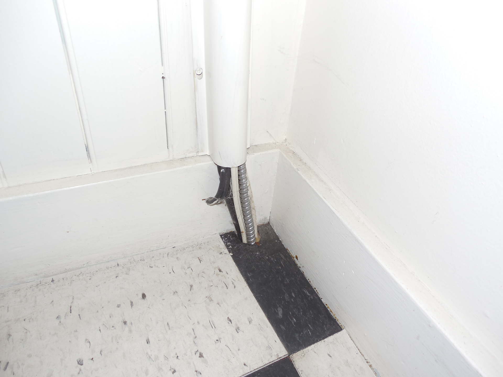

What’s Wrong Here? Hint: Floor Penetration Problem
Hint: Floor penetration problems
There are several types of cable running through the hole in this floor including NM cables and AC cable. When NM cable is run through a hole in the floor, Sec. 334.15(B) requires the cable to be protected from damage by installation in rigid metal conduit (RMC), intermediate metal conduit (IMC), Schedule 80 PVC conduit, RTRC-XW conduit, or other approved means. The conduit must extend a minimum of 6 in. above the floor. No protective sleeve was used at the floor level here. For AC cables, Sec. 320.12(1) prohibits their installation where subject to physical damage but does not specifically require a protective sleeve at the floor the way Sec. 334.15(B) does for NM cables. However, Sec. 300.4 does require conductors, cables, and raceways to be protected where subject to psychical damage. Section 300.21 requires fire stopping be used to prevent fire, smoke, and other products of combustion from spreading through the opening in the floor.
