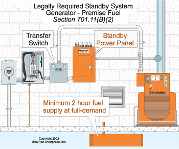

    [701.11(B)]. Here you have several options. Prime mover-driven gen sets need a means for automatically starting the prime mover on failure of the normal service and for automatic transfer and operation of all required electrical circuits, in accordance with 701.7. An internal combustion engine used as prime mover needs an on-site fuel supply with an on-premise fuel supply sufficient for not less than 2 hr full-demand operation of the system (Fig. 1). Fuel storage issues may result in further requirements from the AHJ. Dual fuel supply systems must be able to automatically transfer from one fuel supply to another. Battery power must have a charging means that is independent from the generator. Finally, outdoor gen sets for legally required circuits don’t need an additional disconnecting means on or at the building or structure for the generator feeder conductors if they have readily accessible disconnecting means located within sight of the building or structure supplied (Fig. 2).
