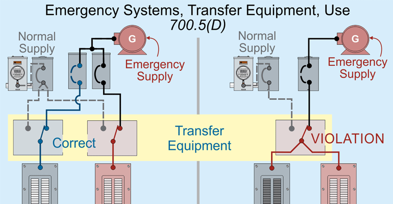

Transfer equipment
With all three types of systems:
• The short‑circuit current rating of the transfer equipment must be field marked on the exterior of the transfer equipment (new with 2017 NEC).
• Transfer equipment must be automatic and be installed to prevent the inadvertent interconnection of normal and alternate sources of supply [Secs. 700.5, 701.5, 702.5].
Transfer equipment for emergency systems must supply only emergency loads (Fig. 1).
