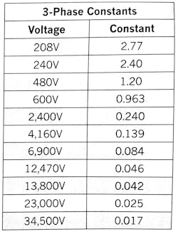

    3-Phase Calculations
    For 3-phase systems, we use the following equation:
    kW = (V × I × PF × 1.732) ÷ 1,000.
    Again, assuming unity PF and solving this equation for “I,” you get:
    I = 1,000kW ÷ 1.732V.
    Now, if you look at the “1,000 ÷ 1.732V” portion of this equation, you can see that by inserting the respective 3-phase voltage for “V” and multiplying it by 1.732, you can then divide that resulting quantity into “1,000” to get a specific number (or constant) you can use to multiply “kW” to get the current draw of that 3-phase load at the respective 3-phase voltage. Table 2 lists each 3-phase constant for the respective 3-phase voltage obtained from the above calculation.
