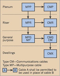

NEC Table 800.50 (Cable Markings) lists the various types of communications cables, along with their respective cable markings and NEC section reference (Table 1). Of these cables, only the top two are listed as suitable for use in ducts, plenums, and other environmental air-handling spaces.
This table lists cable types in descending order of fire resistance rating. In other words, multipurpose plenum cable (MPP) and communications plenum cable (CMP) have the highest fire resistance rating while communications cable and limited-use (CMX) and undercarpet communications wire and cable (CMUC) have the lowest.

Table 800.50 lists multipurpose cables above communications cables because you can substitute multipurpose cables for communications cables. NEC Table 800.53 lists communications cable types and their respective permitted substitution (Table 2). You'll also find an easy-to-use substitution hierarchy in NEC Figure 800.53 (Fig. 1).
