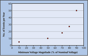

Q. How can I find out how many voltage disturbances to expect from my supply system? Voltage sags and momentary interruptions cause expensive downtime, and I want to evaluate how to improve the situation. Are standards available that summarize the approximate number of these events?
McGranaghan's answer. Most electric utilities understand that voltage sags can affect many industrial processes. However, many don't track system voltage sag performance like they track reliability (utilities define reliability based on outages that last longer than five minutes). EPRI and Electrotek characterized average voltage sag performance for distribution systems in the United States as part of a power quality benchmarking project in the mid-'90s. Fig. 1 above summarizes the average number of voltage sags an industrial facility can expect to see over a one-year period. Of course, there are wide variations in the expected voltage sag performance from one utility to another and from one system location to another within a utility. The most common index for describing voltage sag performance is the System Average RMS Variation Frequency Index (SARFI). It must be qualified by the voltage sag severity of concern. For example, SARFI-70 is the number of voltage sags that occur per year where the minimum voltage drops to less than 70%. The national average is about 18 events per year. Compare that to the national average for the System Average Interruption Frequency Index (SAIFI) — the number of outages lasting longer than 5 min. The national average for SAIFI is about 1.3 outages per year. Ask your utility if they keep the SARFI statistics for the substation that supplies your facility. Note: The estimate should be based on at least five years of historical data because the performance can vary significantly from year to year.
