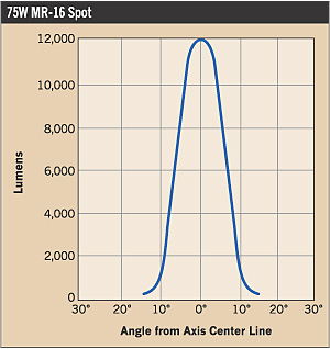

However, because the filament in a LV lamp is smaller than standard-voltage R and PAR lamps, LV lamps offer the maximum optical control using only the lamp reflector. By focusing most of the lamp's lumens in the beam, less light spills out into the field or unfocused area of the beam (Fig. 1). This optical advantage is an energy saver, since light is concentrated where it's needed, allowing fewer fixtures to be used. Additionally, LV lamps are generally more resistant to shock and vibration, which translates into less lamp breakage.
