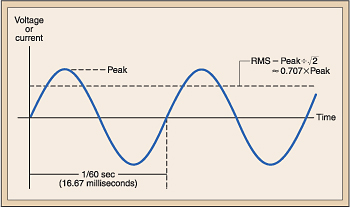

Since AC voltages are generated by round rotors revolving inside circular stators, the resulting waveform is a sine wave. The height, or amplitude, of a sine wave is called the peak value. Instead of peak values, the amplitude of a sine wave is often described as an effective, or root-mean-square (rms) value, which is about 71% of the peak value (Figure above). Most analog and digital meters measure rms quantities.
