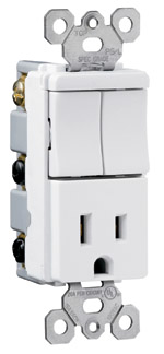

P&S's line of single-gang combination devices allows electricians to install multiple switches within a single existing box during a kitchen or bathroom remodeling project. The products are available in 16 possible combinations, including devices with two switches and a receptacle, four single-pole switches, and a nightlight with a receptacle. Todd Childers, vice president of Atlanta-based Childers Electric, says about half of his firm's work comes from residential renovation and remodeling projects, and when his electricians work on older homes, they have a limited amount of space to install devices.

The combination devices also feature up/down switching rather than sideways switching to make it more convenient for homeowners, who are often accustomed to flipping a switch vertically rather than horizontally. Contractors can designate the main switch for frequently used applications like vanity lights and the smaller switches for secondary applications like fans or heat lamps. To make it even easier for homeowners, P&S designed a snap-in lighting module to illuminate the devices so they can be found in the middle of the night. Contractors can add the lighting feature to any of the devices by removing a plastic tab from the top and bottom and snapping in the light module to create the connection.
“In one second, a contractor can transform a standard device into an illuminated device,” Kulp says. “Instead of having to carry a different part number, the contractor has regular devices in his truck and a handful of these modules. It's very convenient for a contractor and easy to execute.”
