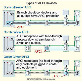

UL 1699 contains the requirements for listing AFCI devices. Each type of AFCI protects different aspects of the branch circuit and extension wiring. However, only the branch/feeder AFCI meets NEC requirements. AFCIs are not designed to prevent fires caused by series arcing at loose connections. Let's look at examples of AFCIs.
Branch/feeder AFCI.
This device is installed at the origin of a branch circuit or feeder like a panelboard. It provides parallel arc-fault protection for branch circuit wiring, cord sets, and power supply cords. It's not UL-Listed to provide series-type arc-fault protection.
Combination AFCI.
This device, which is typically a receptacle, provides parallel and series arc-fault protection for branch circuit wiring, cord sets and power supply cords downstream from the device. It doesn't, however, provide parallel arc-fault protection upstream.
Outlet circuit AFCI
This device is installed at a branch circuit outlet. It provides parallel and series arc-fault protection for the cord sets and power-supply cords plugged into the outlet. However, it doesn't provide arc-fault protection on feed-through branch circuit conductors, nor does it provide parallel arc-fault protection upstream from the device.
Although AFCIs have their uses, it's important to note that these protection devices are not designed to prevent fires caused by series arcing at loose connections in devices like switches or receptacles.
